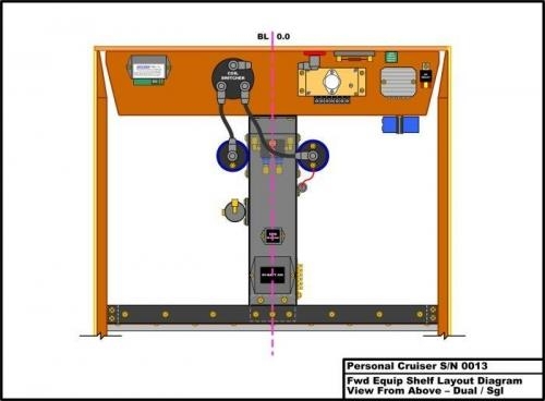

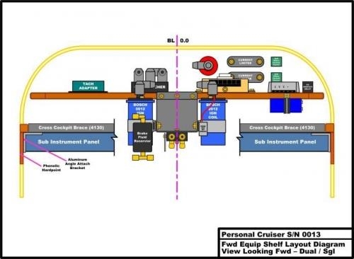

Brief Description:  Fwd Equipment Mounting
The fwd avionics shelf supports the tach generator (tooth counter on flywheel) as well as mounts for various components of the engine ignition system and braking system as well as electric rudder trim and the backup batteries for the SkyView displays.
