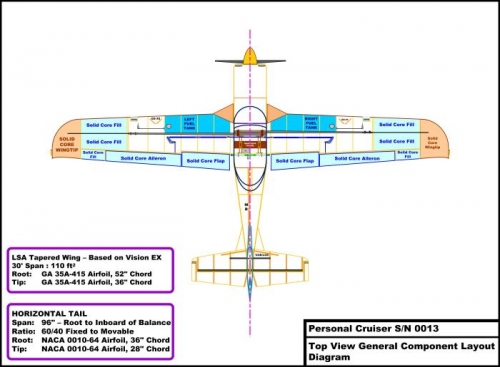

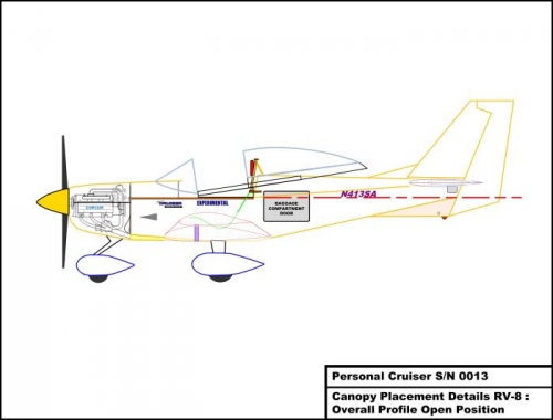

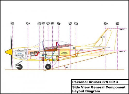

Brief Description:  Fuselage Componenet Layout Design
There are numerous component layout design decisions to make based my my decision to create a hybrid of the Personal Cruiser fuselage with the wing, tail and landing gear of the two seat Vision. Chief among them was the location of controls due to the need to use a side stick instead of the usual center stick. In addition the tunnel through the fuselage for the gear had to be properly located and a belly board speed brake had to be located along with its controls. This also includes electrip flaps and a generous baggage compartment behind the seat with an exterior door. The details might change down the road but this is what it looks like right now in my head.
