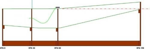

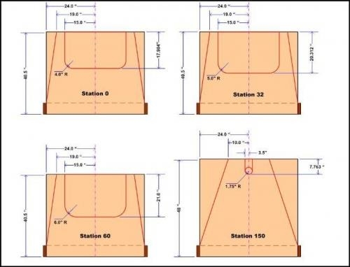

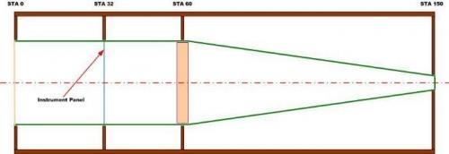

Brief Description:  Fuselage Formers Design
Since I have elected to build a fuselage that is constant width through out the cockpit and firewall the stock design for the fuselage forms wont work. These are my design for the forms to build a 30" fuselage with a flat belly section to accomodate a belly board speed brake and fuselage mounted main gear.
Side View
Side View
Top View
Top View
Form Construction Details
