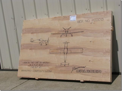

Brief Description:  Kit A Arrives
The very large flat box arrived today with Kit A. This was purchesed without the V tail components as I will be using the conventional tail from the 2 place Vision design. The fuselage uses the Fold-A-Plane concept of building so the fuselage kit consists of numerous foam panels that are glassed on one side only. When joined they are set into forms and the interior is glassed to stiffen the structure.
Kit A - The Fuselage
