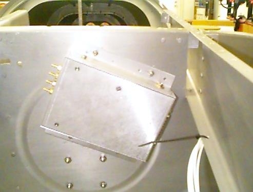

Mounted the AOA CPU on the rear of the center bulkhead. I used 3/4" angle and #6 screws. I installed nutplates to eliminate the need for nuts and washers.
AOA CPU mounted on the rear of the center bulkhead.
