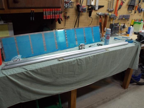

Brief Description:  Completed assembly of Aileron Pushrods
Sprayed inside of aluminum aileron pushrods with primer and completed assembly of the pushrods for both the left and right ailerons. Had some difficulty with the rivets on the short steel pushrods. A few of them got set offset and some minor smiley faces on the heads. Will need to ask an EAA tech adviser if they're OK. If not, when I remake them, I'll have them welded.
Completed Aileron Pushrods
