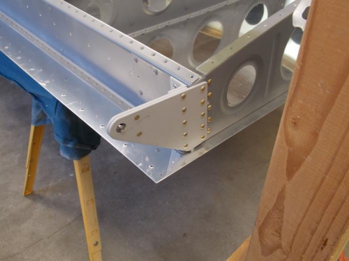

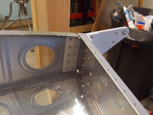

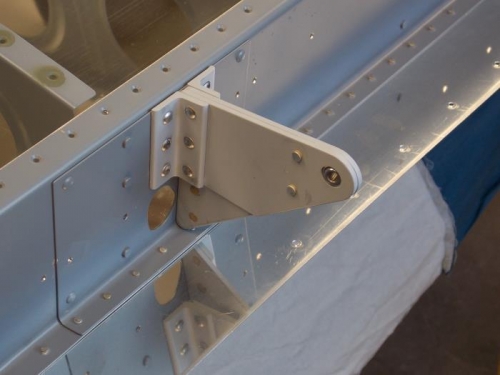

Installed both aileron hinges. Inboard hinge worked out great, but when I drilled the holes for the outer hinge, I noticed after I had already drilled that I hadn't clamped the hinge in place correctly. Ugh! Resulted in misaligned holes when I clamped the hinge in the correct location. So I decided to re-drill the holes (making them elongated) and installed a doubler to overcome the elongated hole problelm. See images 2 & 3.
Inboard Aileron Hinge looks great.
Doubler on Outside Hinge (my mistake)
Outboard hinge with double rivets
