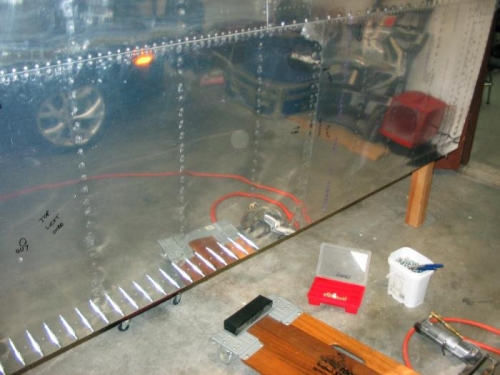

Brief Description:  Rivet Left Wing Trailing Edge & Worked on Ailerons
While I riveted the trailing edge of the left wing top skin, Todd worked on the ailerons.
Some of the inboard rivets on the trailing edge rivets were a bit tought to get on, but I took my time and got on them OK. The remainder of the rivets were squeezed. Got about half of them done in between helping Todd with the ailerons and getting an ab workout getting up and down off the floor.
Todd trimmed the blue plastic from the left aileron skin and clecoed all of the skin stiffeners in place. He drilled them out and dimpled the skin. He's picking things up quick. Soon, he'll be telling me what to do.
Started Left Trailing Edge Riveting
