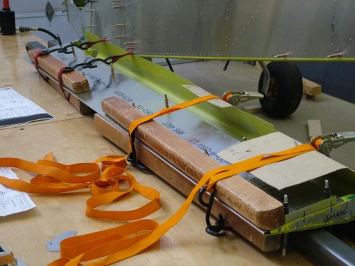

The L IB flaperon had been primed with zinc oxide and was ready to reassemble. I reassembled the skeleton to the ribs on the bottom of the ribs and then fabricated the inboard full rib which has the attachment to the wing attached to it. This rib also attaches to flange inside and requires some careful alignment.
The R OB flaperon skeleton had been clico'd through the small pilot holes. I drilled all these holes, disassembled, deburred and then primed them and left to dry.
Rib primed and riveted

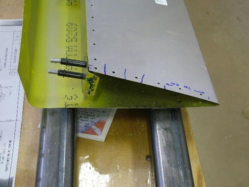

Folding skin over leading edge

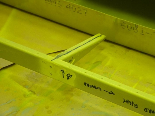

The full rib showing flange
