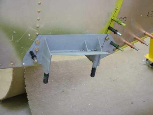

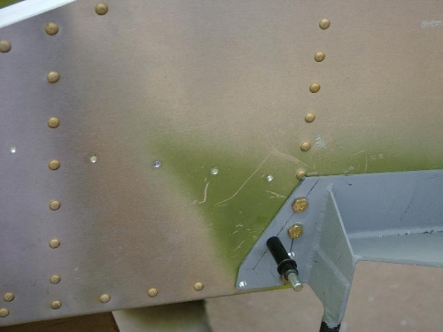

Finished up fitting the left hand seat base. This required the holes in the fuselage side. The positions of these holes had been marked by fitting the seat base in snugly and spray painting the INSIDE. This left little paint marks on the inside of the skin and the holes could be drilled from there accurately enough to allow clico's to the seat base.

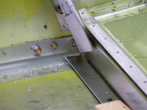

Then the left hand strut fitting was placed in position and drilled and cleco'd and/or bolted in place. The fitting was held with duct tape for the first holes.
