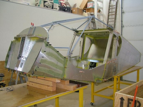

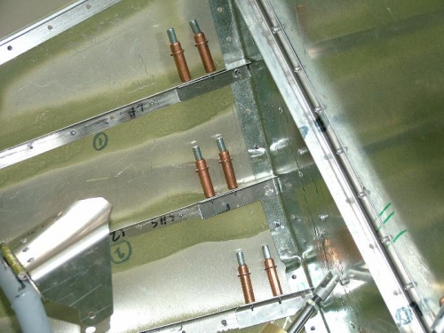

Finishing the fitting of the RH seat support I then did the left hand seat support. Finishing that, I moved on to the installation of the firewall. This went fairly well. I had to remove the end supports of the rudder pedals and some of the early rivets. The stiffners in the fwd skin were supposed to overlap the firewall flange but I had not done that. (The drawing is very iffy about that, but the photo guide, which had not been released when I did it, is very clear. There must be overlap.) I made extensions on mine which are shown in phot0 3 below.
View with firewall cleco'd on.

Extensions on the
Extensions on the "L's".
