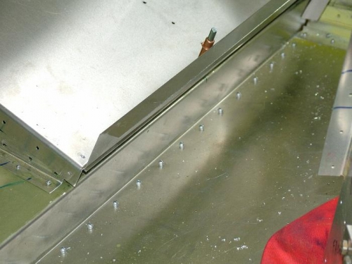

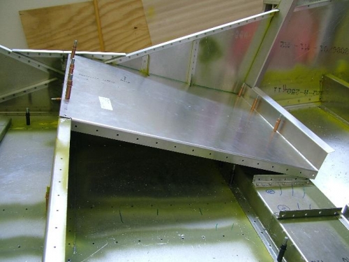

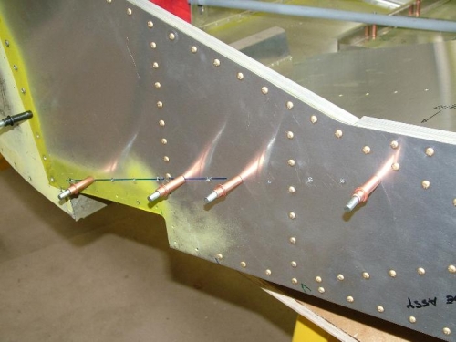

1.0 of these hours were Carole's.
The seat pan is attached over supports and is riveted to the outside skin. Depending on what has been done before, this can be difficult since it is all hidden. What I did was to clico it in place using the predrilled holes. Then I took off the center support and, using a zinc oxide spray can, put my arm under the seat pan and sprayed against the outside skin. This left little spots on the outside skin through the predrilled holes in the seat pan. Removing everything then, the holes were easy to drill and lined up perfectly.
