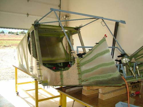

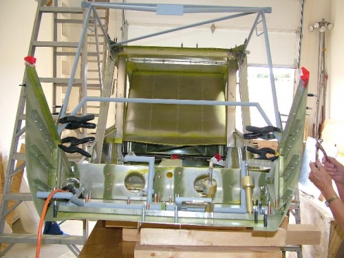

Brief Description:  Joined fwd and rear fuselage. Control linkages
Of these hours, 0.9 were Carole's.
These hours include work on 23,24,25.and 26 June 2009.

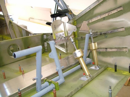

The fuselage was joined with help from the Hedges family on 25 June. The tubular cabin frame was also clamped into place. Later all the holes of the join were re-drilled and clico'd to their final value. The flaperon linkages were checked and the bolts tightened to final value (a missing cotter pin and a proper length bolt to connect a brake actuator is holding this up. The rudder pedals were mounted and the brake actuators installed loosely.
Joined fuselage from front

Rudder pedal/brake area
