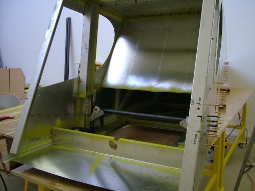

Got all the pieces together and installed (with clicos) the flap motor and the flaperon cross bar. Located the bolts but the castellated nuts were not to be found. All is temporarily in place.

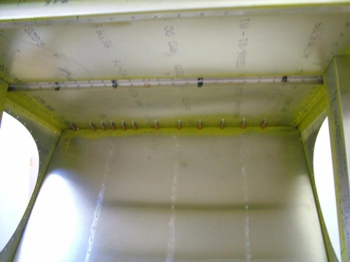

Then got the top skin on which completed the 4 sides of the rear fuselage. All is held with clicos for now. Then got the back of the baggage compartment in place with clicos. Will continue with the baggage compartment and forward inside the rear fuselage on next session.
Photo 1 shows the flap motor and the flaperon cross bar. Note that in the previous report the crossbar was positioned in the wrong rotary position. Had to be removed and corrected for the flap motor to fit.
Photo 2 shows the 4 sides in place and the rear of the baggage compartment going in. Photo 3 shows the top of the baggage compartment rear.
