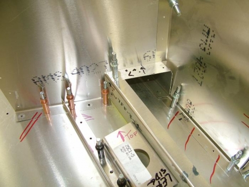

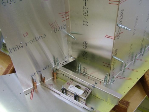

Did careful study of the plans for the internal structure of the rear fuselage including the baggage area and the control connections under it. Accumulated all the parts in one place for this part of the inner structure and then temporarily cleco'd them in place to try to better understand the plans in this area.
Figure 1 is the bottom side of this structure. The bottom of the baggage compartment is on the left. Under that can be seen the hole where the controls go into and the structure forward of that. All of this was left clico'd as time ran out.
Figure 2 is a detal of this area.
