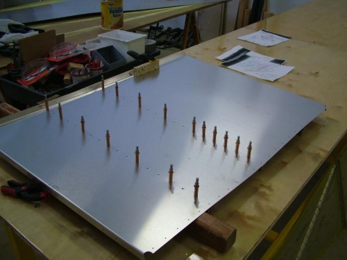

Drilled the holes for the rudder hinge and tie-eown on the lower hinge bracket and then for the A5 rivets to hold it on.

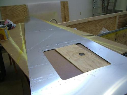

Began and finished the deburring of the bottom skin and all attachments. Took another look at the top skin and decided that the baggage back should be attached to the top before the rear fuselage is assembled. The rivets would be impossible to drill for when the rear fuselage is assembled. Started re-inforcing the baggage back panel with L's.

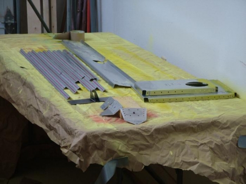

The parts off the bottom skin ready to treat for corrosion.
The bottom skin.
The bottom skin.
The baggage back panel.
