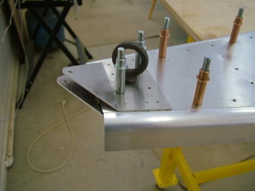

Carole continued ;positioning, measuring, drilling and cledoing the diagonal "L" sections on the bottom skin. I fabricated the rear tie down assembly, drilling the holes for the rudder hinge and the tie down itself on the drill press. The bottom rudder hinge has a 3/16 inch hole while the upper one has a 1/4 inch hole with an interior bushing.

Detail of rear tie down and bottom rudder hinge.
