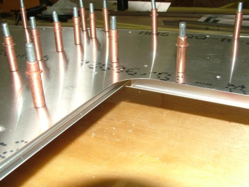

We started the day with the corner longerons drilled and clico'd. From there we positioned the Z sections that stiffen the hole in the bottom skin and drilled and clico'd them. Also the structural member which goes across the fuselage in front of the hole. Then positioned, drilled and clico'd all the L sections which cross the bottom skin. The diagonals were left for the next session.
The bottom skin, being the last of the four sides of the rear fuselage, was easier to do as we got better and more efficient as the experience level grew.
