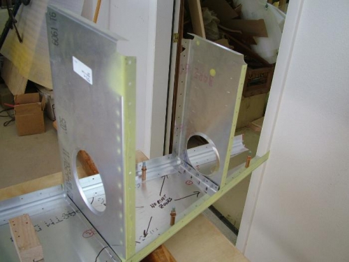

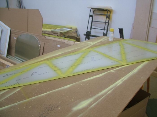

Continued drilling and clecoing the cross pieces and diagonal stiffners to the top skin. fitted the two bulkheads at the rear and made sure that they fit ok when later assembling. Deburred all drill holes and treated all mating surfaces with Zinc Oxide and left to dry.

Detail of rear bulkheads

Treated skin.
Treated skin.
