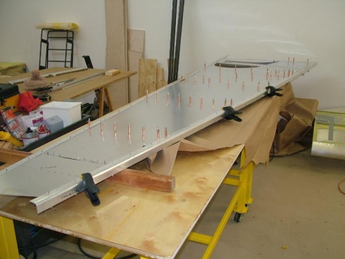

Fabricated the L sections which crisscross the side of the fuselage. Then clamped them on, drilled from the tiny holes on the skin, and cleco'd them in place. About half done with this.
I have spent a lot of time trying to anticipate the connection of the rear fuselage piece to the front piece so as to prepare the side panel optimally.
The RHS with clecos in place
