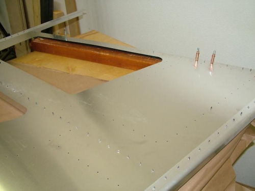

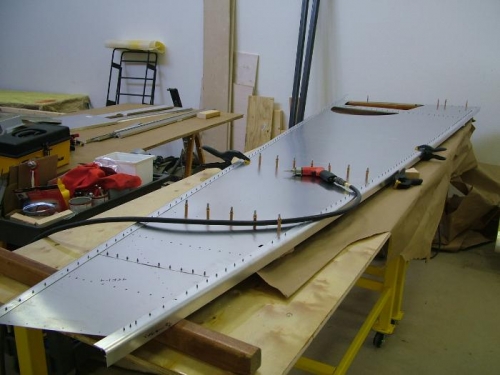

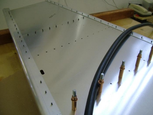

Drilled the holes to attach the bottom and top longerons to the RHS skin. Put clicos in every one. Skipping clicos created "bubbles" in the skin. Measured the longerons to cut to size later. Cut the L's to size for the upright stiffners and got two of them clico'd in.
The RHS about finished
