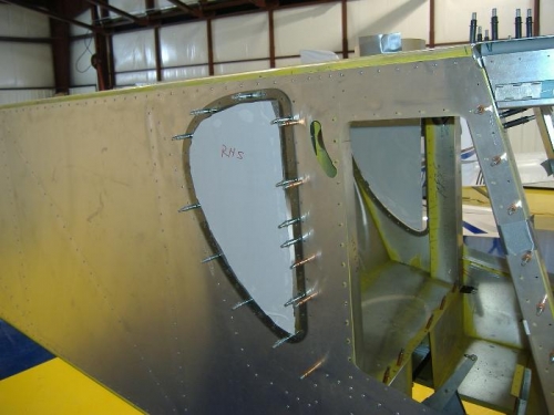

All the back windows have been fitted and pilot holes drilled. This posed no problems. We used the DeWalt drill for this to get a slower speed through the plexiglas.

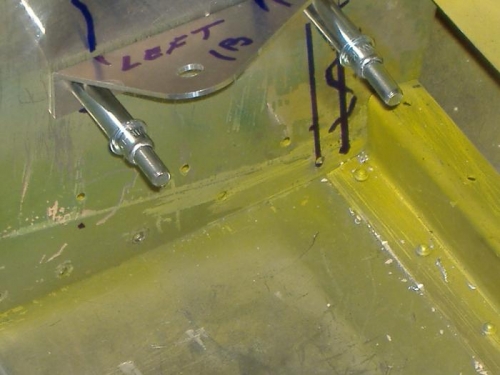

All the cabin trim items have been located and duct tape into position. Some pilot holes have been now drilled. The L hand seat pan was removed and the positons for the nutplates located and pilot holes drilled. The left hand seat belt attachments are in place with clicos. The location of the shoulder harness attachment is not given. I have called about that.

RH seat belt, RH seat

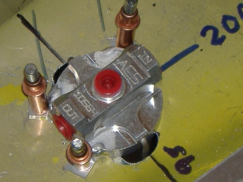

Gascolator under LHS seat
RH back window located
