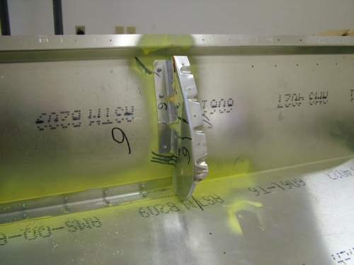

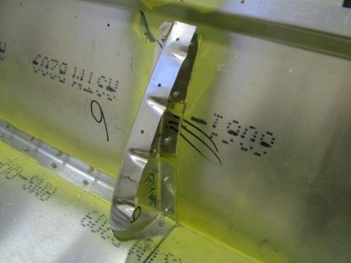

Started the day by applying zinc oxide to the right slat skins and to the ribs and skin of the two left slat sections. (Each slat consists of two sections which will only be connected upon installation on the wing.)Then re-clico'd the right slats and rivet them, finishing them. See figure 1. Then re-attached the ribs to the outboard section of the left slats and riveted them. See figure 2.

The rib attached to the skin
The other side showing bent
The other side showing bent "L"
