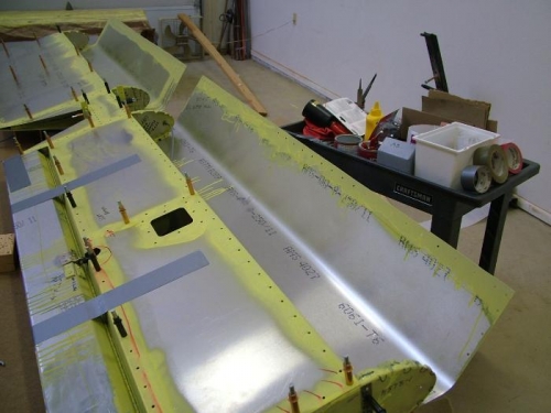

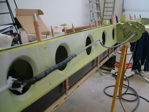

The elevator, after having all the meeting joints treated with zinc oxide, was carefully reassembled completely. Then with caution as to whether to use A4 or A5 rivets at each location, the riveting was started and completed with the attachment of the mounting bracket and control horns. The elevator with installed servo and trim tab is complete.
Showing cable run from servo
Reassembling the nose skin
