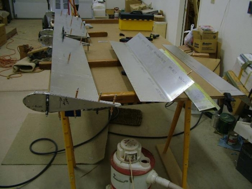

Deburring all pieces begins

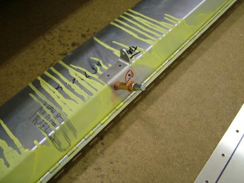

The actuator tab on the trim tab

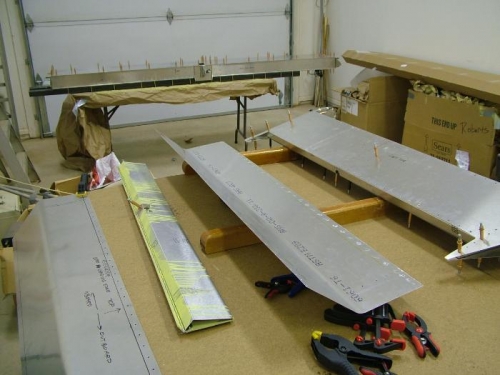

Taking it apart for deburr/Zinc Oxide
