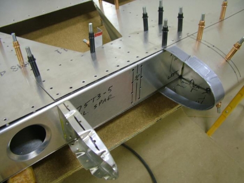

Brief Description:  Trim nose skin on elevator
The nose skin for the elevator comes from Zenith some 20=30 mm too wide. This is to ensure that there is enough to wrap around the nose spars and insert into both the top and bottom rear skins. After fitting and clecoing, it is necessary to trim the excess off. I did this on the bandsaw and filed the small meanderings off of the right hand elevator nose skin. I also deburred all the holes and the new cut.
The nose skin removed and trimmed
Detail inside the nose skin
Detail near the center of the elevator
