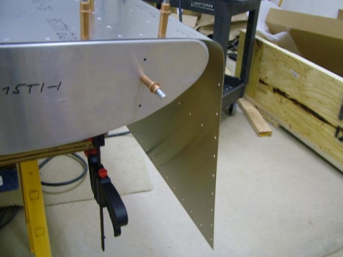

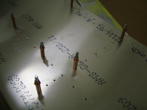

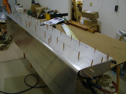

Riveted all the spar doublers (4) to the spars. Prepared to apply skin and with Carole's help laid the large sheet of aluminum in place forming the top of the stabilizer (which is flat.) With slight adjustments made sure that the spars, rear ribs and nose ribs were under the pre-drilled small holes. Carefully drilled all positions and left cleco'd as the day ended.
Skin on bottom of stabilizer
Detail
Detail
How skin wraps around
