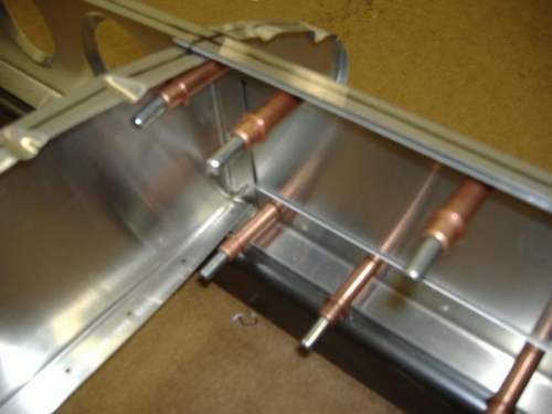

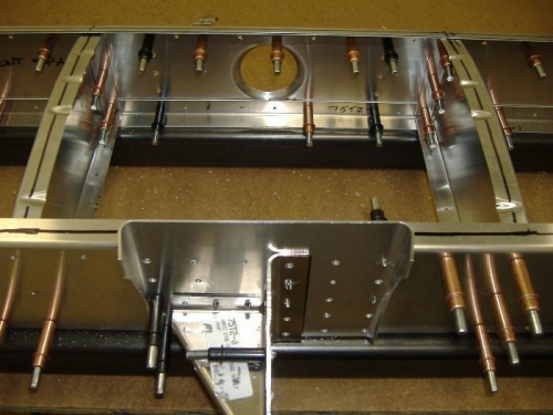

Fabricated the stabilizer rear center bracket and drilled and cleco'd it into place temporarily. Drilled and cleco'd the rear end brackets. Drilled two holes to accept the AN-3 bolts which hold the center bracket on.The stabilizer skeleton is complete and ready for skinning with the brackets temporarily removed to keep them out of the way. There is no need to rivet the skeleton now before the skin is applied so have elected to keep the clicos in until the skin is an assured fit.
Rear Center of Stabilizer
Rear Spar. Ready to skin.
