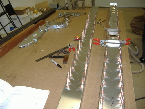

Date:  1-13-2009
Number of Hours:  7.00
Manual Reference:  Photo Guide, Plans
Brief Description:  Fabricate front and rear stabilizer spars
Went to town and purchased quick connect fittings for the air drill and the air riveter and connected them and checked them out. Also got air tool lubricant and safety glasses for two workers.Prepared the clamps. In afternoon and evening fabricated the front and rear spars by adding doublers now being held in place by clecos with all holes drilled for riveting. Began to add brackets to the spars. Stopped when the photo guide seemed to contradict the plans as to the direction of two of the front brackets.
Front and rear stab spars.
