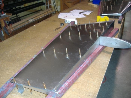

Trimmed skin to shape. Riveted all ribs to complete skeleton
Applied rear skin, drilled holes to ribs and spar and cleco'd
Applied front skin, drilled holes to ribs and cleco'd
Disassembled and deburred. Reassembled and riveted. (Cortec had been preapplied.)
Inspected by factory engineers.
Rear skin drilled and cleco'd

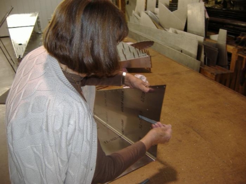

Carole de-burrs the drill holes
