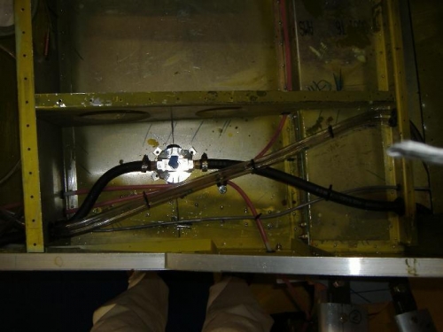

Barrie and I hooked up the cables to the rudder and did some trimming of the elevator where the tolerances were tight. We forgot to cross the elevator cables so on the 13th I disconnected the cables and re-installed. After the crossing, one of the cables is too short to center the rudder with no more than three threads showing on the turnbuckle. So we will build another cable to replace that one.
I completed all the connections through the underside of the left seat. These consist of the fuel line through the gascolator, the two brake lines, the pitot lines and the wires from the trim tab. All the other wires will go down the right side away from the fuel lines.

Under left seat
Under left seat
