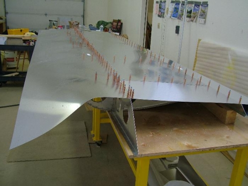

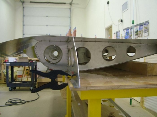

Continued drilling and clicoing the skin sections to the bottom of the right wing. These included the I/B and O/B sections of the bottom skin and the nose skin and the training edge skin. When alll these finally clico'd, began to take it apart and deburr the pieces.
Great care was taken to avoid twist in the wing . The bottom skin is flat to 0.1 degrees from end to end.

The completed bottom
End view
End view
