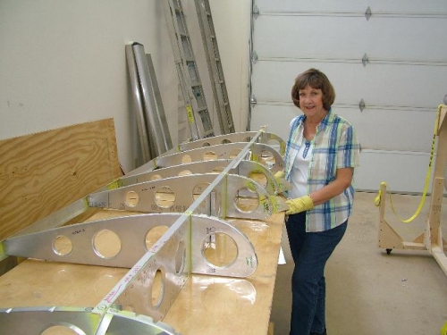

After finishing the right wing and constructing a rack to hole it (and when finished both wings), we started on the left wing. I reviewed the plans, the photo guide and the Homebuilt DVD. We assembled the parts and clico'd the skeleton together. Then we took it apart, deburred it and applied zinc phosphate where metal meets metal.
On 5/31 we clico'd on the bottom skins. I gathered together all the parts which attach to the wing and none are missing. I note there is apparently an error in the plans for the attachment for the front auxilliary strut and will call the engineers about it. This will not delay the project. The bottom skin was drilled to #30 drill and copper clico's as we secured.
Skeleton riveted
Skeleton riveted
