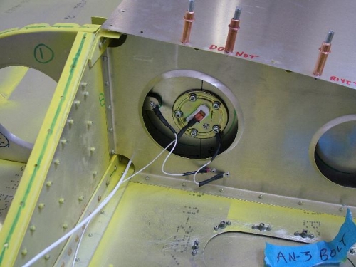

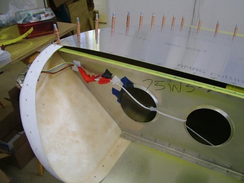

During this period the right wing was taken apart, treated for corrosion and the inside got ready for completion. The R wing light was attached and wired with the 4 conductors carried to the inboard edge through a channel right behind the main spar. A 4 conductor shielded cable was used.
The fuel tank was padded into place using the supplied cork strips. It became a snug fit. The fuel sender was bent as instructed and installed.

Detail fuel sender, wires
Wing wiring in Rescue tape.
