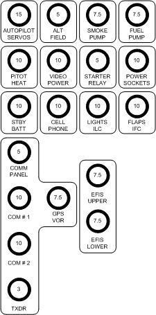

Brief Description:  01 - Circuit breakers
Circuit breakers
Today I spent a little while thinking about the layout for circuit breakers. I will be using fuse blocks for many of the non-essential items, so I don't need expensive breakers for all the circuits. The aim is to make the panel four breakers wide to fit down the pilot's right arm-rest area, but layed out intuitively to minimise confusion in a potential emergency.
Not all the values are correct yet ...
