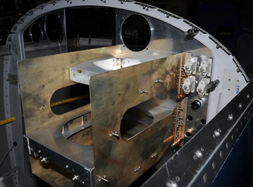

Brief Description:  Avionics rack
Avionics rack
I drilled the mounting holes into the avionics rack to coincide with the mounting holes for the Dynon SkyView screens. That will allow me to install screws into nutplates from the front of the Dynon screens while minimising the space consumed by the rack. Panel real-estate is limited, so it was important to leave enough room for the bank of switches down the left side.
