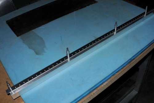

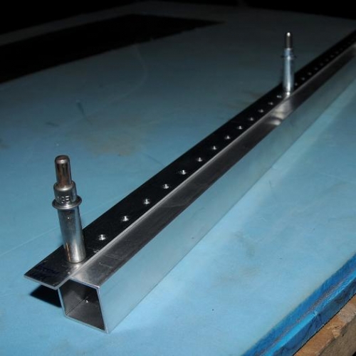

Rudder trailing edge
Drilled the rudder trailing edge doubler to a 1" x 1" square aluminium tube. The tube will keep the trailing edge straight while the ProSeal sets. I then countersunk both sides for double countersunk rivets.
