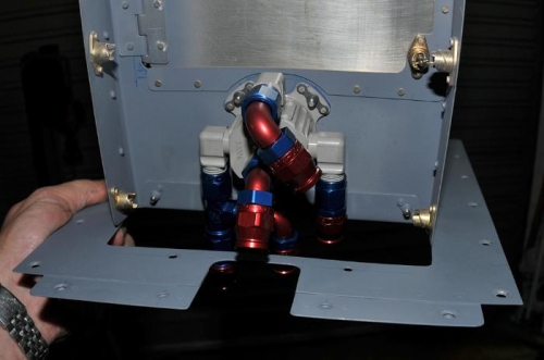

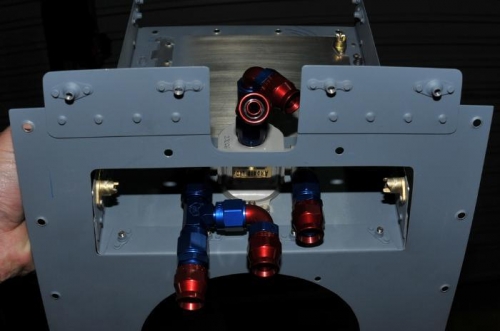

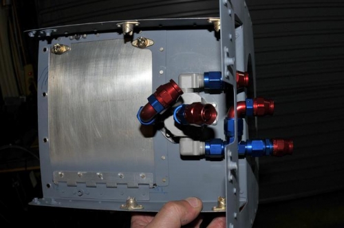

Brief Description:  06 - Fuel lines
Fuel lines
I mapped out the way to connect the fuel lines to the Andair fuel valve. The return from the AirFlow Performance purge valve will run into the right tank if the left tank is selected for start. This ensures only cold fuel will be circulated to the engine during priming.
