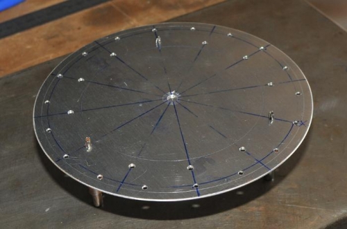

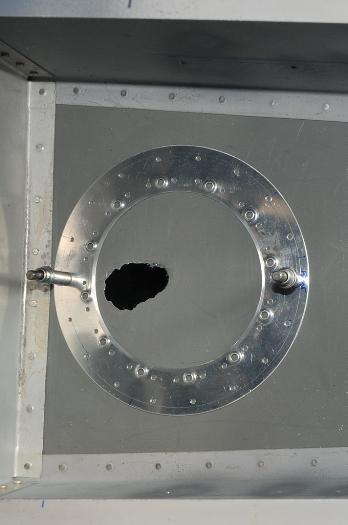

Brief Description:  Gascolator access panel
I made an access panel to get to the gascolator bowl from under the aircraft. I need to get a whole hand through to unscrew and then replace the bowl after cleaning, as well as fit lockwire. The fuel drain will just protrude through the bottom of the belly skin (cover plate) when I'm done.
