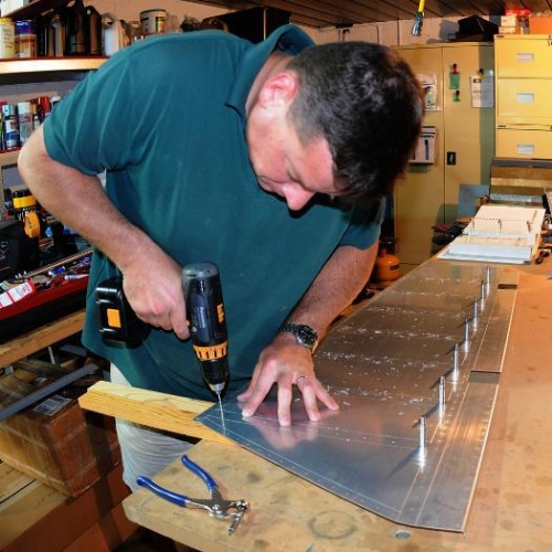

Trimmed, polished, drilled, deburred and dimpled elevator skins and stiffeners. It was much more efficient to drill the first hole in each stiffener, draw the alignment line, then cleco them all in place before turning over to drill the rest of the holes.
Drilling & clecoing the other end
