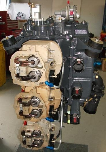

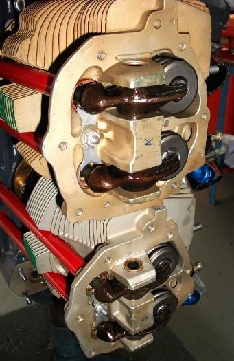

Brief Description:  01 - Pushrods & rocker arms
Installted pushrods all-round, then installed the rocker arms and measured for 0.028"-0.080" gap. Some pushrods needed to be swapped out for slightly longer and shorter lengths to suit. The red rocker covers and intake tubes will be installed after being powder-coated.
