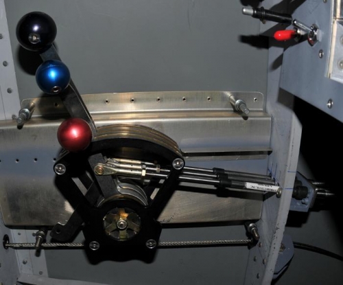

Brief Description:  03 - Throttle quadrant
Throttle quadrant
The throw of the throttle lever isn't quite enough to match the throw of the fuel servo control, so I reduced the diameter of the stop bushings in the throttle quadrant to allow slightly more travel in both directions. The alternative was to use the lower hole on the fuel servo control lever, but I prefer maximum fidelity with the throttle.
