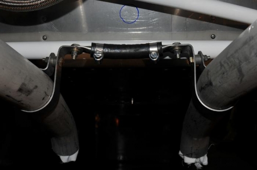

Brief Description:  01 - Exhaust support brackets
I want to increase the bend radius on one of the oil lines, but there isn't much room to work with, so I fitted the intermediate exhaust support brackets. I trimmed the stainless tubes and belled the ends, then cut some rubber joiner tube and fitted everything in place. While I was at it I considered where to put the cabin heat shrouds, ducting and pilot-operated gate. Windshield defrost will be tapped off these lines as well.
