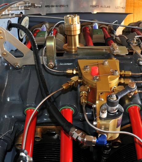

Date:  5-21-2012
Number of Hours:  1.00
Brief Description:  01 - Fuel return line
Fuel return line
Tonight I began fabricating the fuel purge return line from the AirFlow Performance divider back through the firewall to the fuel system. The fittings in this path are steel on the firewall side, so I used a grommet through the baffle rather than a bulkhead fitting - to minimise weight.
