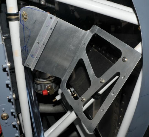

Brief Description:  03 - Oil cooler bracket
Oil cooler bracket
I made some adjustments to the oil cooler bracket so that I could fit the front Adel clamps. I may change the orientation of these a bit, since it's hard to get the bolts through the nutplates from the back and a bolt head will be lower profile than the nutplate and thread - important given that a duct is still required in front of the oil cooler.
