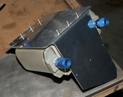

Brief Description:  02 - Oil cooler
Oil cooler
