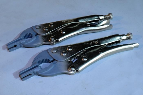

Brief Description:  Adel clamp pliers
Adel clamp pliers
Fabricated Adel clamp pliers to make assembling multiple clamps on engine mounts and fuselage trusses easier. I have also geared up to start making these for sale for other builders that understand how pesky Adel clamps are to hold while putting the bolt through!
Simply use and ice pick or the like to align everything, clamp the cluster with the pliers, remove the ice pick and install the bolt. They suit AN3 sized bolts and anything smaller.
