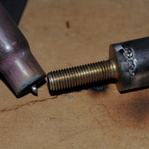

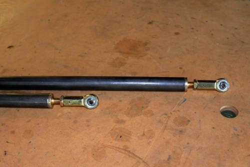

Brief Description:  Elevator control rods

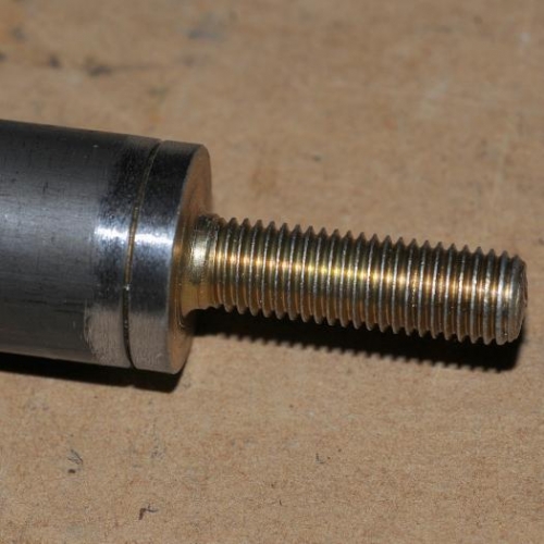

Welded the rod ends into the elevator control rods. At first it was a disaster - even though I ground off the CAD plating and cleaned with Acetone, obviously the CAD on the inside and perhaps some tube forming lubricant caused the 4130 to explode the moment it reached melting point.
Inserted
Inserted
Ready, set, go
Ready, set, go
Stop ... more prep required
