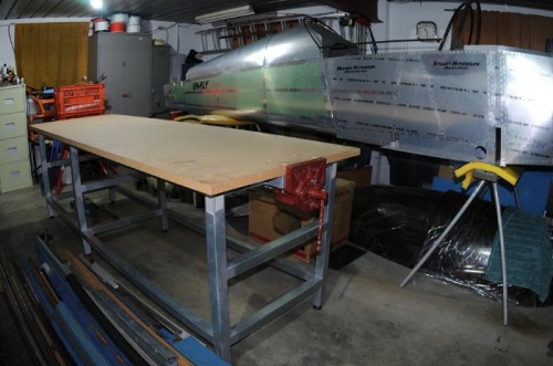

Brief Description:  9' workbench construction
9' Workbench Construction
Mounted the wood vice, leveled the bench top with shims and then set the top down in a bed of liquid nails (with grease paper to avoid it sticking to the steel frame). I'm hoping the top will be well supported all round, but replaceable when I'm done with the thousand or so cleco alignment holes yet to be drilled!
MDF top glued and setting

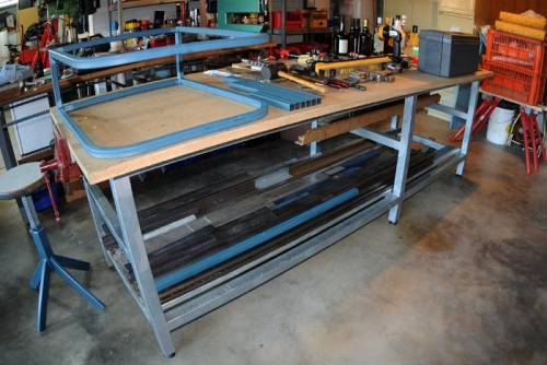

A new steel rack = more space to work !
