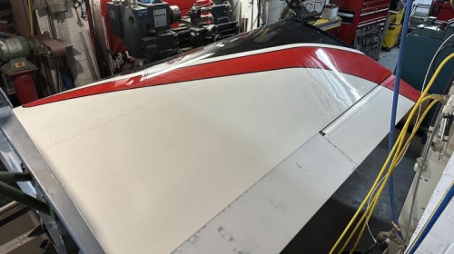

Aileron rigging.
I hung the starboard aileron and connected all the pushrods. Next, I'll pin the bellcranks in the neutral position and trim them main pushtubes to proper length and permanently install the rod ends. When that's done I can install the wingtips, align everything to neutral, lock the jam nuts and check for proper torque tube clearances and throw angles.
